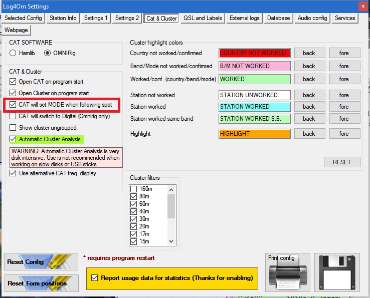

Hello all, just got a Yaesu FTdx 3000 and after setting it up in Log4OM when I click on a station in the cluster list, let's say going from 20 meter USB to a station on 40 meters LSB, the rig will go to the correct freq. but stay on USB and not change to LSB or the other way around.
I'm using Omni-Rig and the setting are:
Rig type: FT:2000
Port: COM 6
Baud rate: 9600
Data bits: 8
Parity: None
Stop bits: 2
RTS: High
DTR: High
Poll int. ms: 500
Timeout. ms: 4000
I'm running Version 1.25.0.0 (the latest version). Any thoughts?

Thanks Terry, I'll look into this when I get back home on Wednesday. 73

Terry, enabling this has worked just fine my friend. Now the mode tracks and changes with mode change. Thanks for the help. 73
