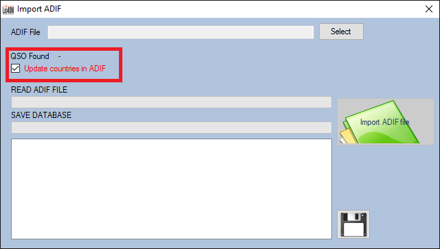

Have you checked this option when importing your ADIF ???

All of these issues are caused by the other logging programs not exporting a complete dataset
Log4OM provides the tools to rectify most issues cause by incomplete imported ADIF files with the country update choice in the import screen and the other powerful tools in the QSO Archive manager
