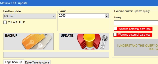

I'm looking for a way to edit the Receive Power field to keep track of some QRP and QRPp contacts. I can enter the Receive Power in the F5 Extended Info group, but if there's a mistake, or if the power reads wrong on imported files, I can't find a way to correct it under the QSO Manager or by double clicking the contact. How can I handle this?

Admittedly there is no provision in the QSO edit screen for changing the RX power but this is because it is so rarely required.
However it can be edited in the QSO Archive manager as shown below
