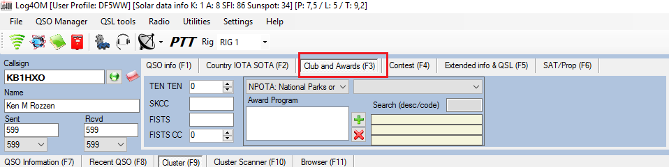

Worked KB1HXO as he activated TR06. Went to Awards and there was no NPOTA in the list. I tried with several other calls and it was not listed for any. Why?

No problem to find NPOTA here. Tried with the same callsign. Under Clubs & Awards i find NPOTA as the second entry.

I have an installation at home and I use it all tyhe time no problem.
I just did a new clean install on a new computer for my Dad and this install does not have the NPOTA. Hence my question.

Update the Award files per the manual.

Finally got back into my Dad's shack and tried the update and it did indeed work. Thanks agn.
