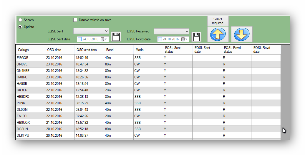

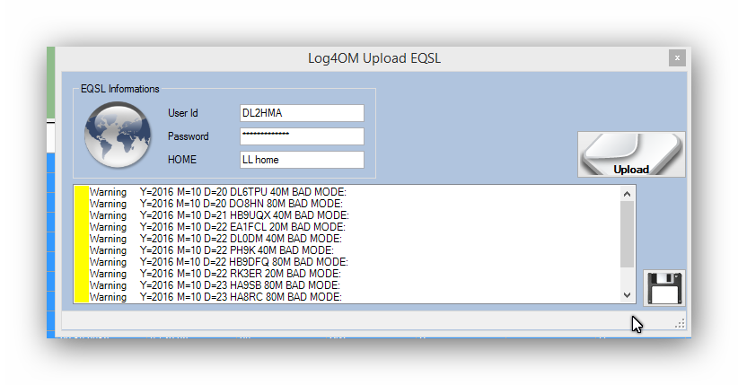

Dear Terry,
thanks for the information. I have watched the video again and found nothing have been done wrong.
See attached extract from the QSL Manager with the list for eQSL upload and then the error message from the upload trial.
> the same message: bad mode...
Why this happens, what is wrong?

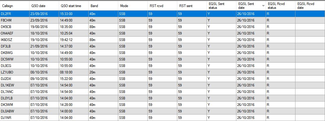

Gerhard,
The eqsl message of bad mode is because NONE of your QSO's have a mode recorded!
Add the correct mode to each QSO and they will upload fine
To prove this I added the mode SSB to those QSO's that had an RTS like 59 etc and tried an eqsl upload and some of the results are shown below.
