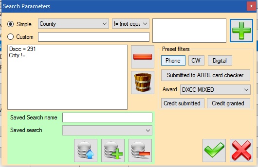

Yes you can bulk edit in the QSO Manager
First do a selection parameter sort as below
Then select groups of counties that don't have the QSO Award field completed and go to field update and edit the QSO Award field as required.
If the county names happen to be in the comments field then you can use the provided update for awards in the field update screen
