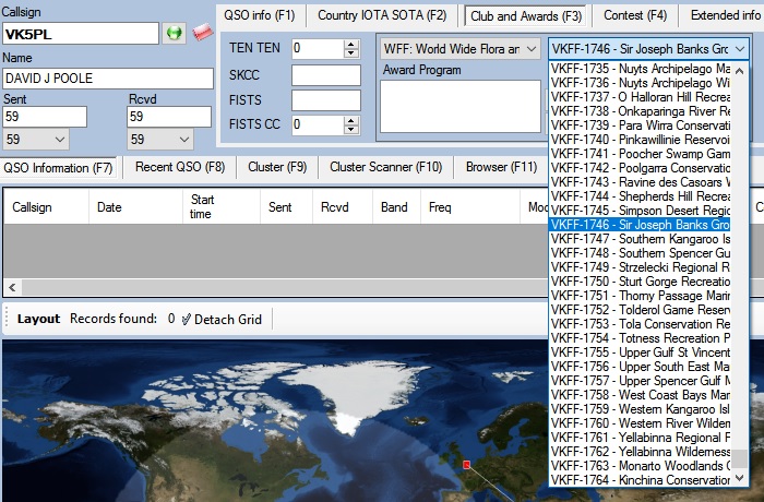

Same thing with your file, imports OK, but no new parks in the awards drop down with F3.
I will send your file to Claus and see if he can get it to work.

VK5PL wrote:Thanks for the help Terry to bring back the WFF database.
Now there is good news and bad news. The good news is I was able to merge the new parks using the corrected file with no quotation marks.
The bad news is that the new parks do not appear in the awards drop down under F3, except for one that I edited due to a strange character.
Just received your file, will try that.
The dates in your file were incorrect, I removed the ValidFrom and ValidTo dates and merged your file using the global date range set in the award and it all works fine
