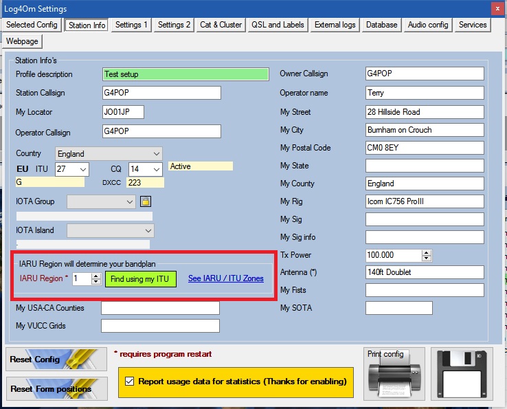

This seems to indicate that you have the wrong region selected in the Log4OM options, see screen shot below.
For America set it to Region 2
If that is not the problem then you can edit the bandplan_r2.xml file to adjust the frequencies that correspond to your specific requirements.
