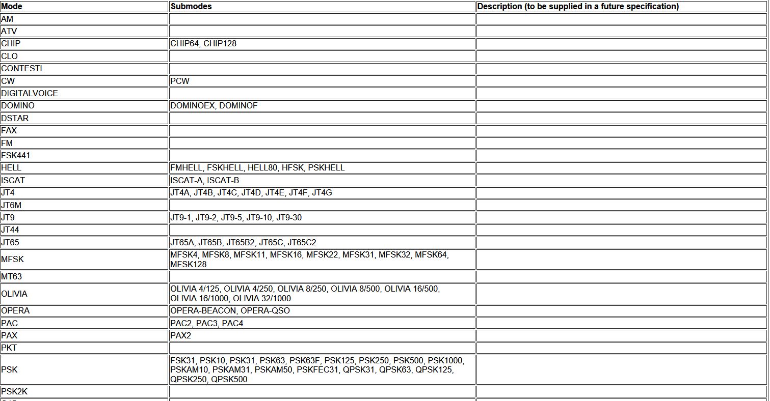

MSK144 is not a recognised ADIF mode at this time so be aware that any QSO's uploaded to award programs like DXCC will probably be rejected. See the current ADIF mode list below.
However if you still want to change it, try editing the csv file using notepad and of course just save it don't use save as.
You can edit the RST values for Digi mode, CW Mode, Voice Mode & JTxx Mode by going to options/select config tab and enabling expert mode, same as for editing the modes list etc
