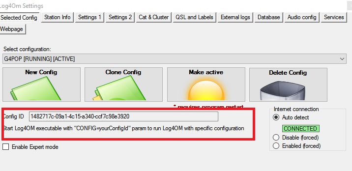

The question is: can Log4OM be started with e.g. command line parameters for this special event to select a different call and logbook + settings for clublog etc?

Yes probably the easiest way is to create a new configuration for the new call and upload Options/Select config then either clone the existing config or create a new one.
Just use the appropriate information in the new config and then you can create a desktop shortcut using the config ID to start that particular set up.

I know it can be set up manually. What I am looking for is a simple way to start Log4OM with ALL relevant settings set correctly for the call in use.

Michael that is exactly what I am trying to describe!oz8agb wrote:Hi Terry,

Assume I have three different configuratioons as follows
G4POP - Home location in Essex
G4POP/MM - My Yacht
G4POP/a - My DX location on Orkney Island
Each configuration will have a different 'Config ID' as shown in my last post
So set up three different desktop shortcuts with the relevant Config ID for each one in the Shortcut properties command line something like below
G4POP uses shortcut ID Config=dcf0666e-dfa0-4ba9-8617-fca69aa76ec4
G4POP/MM uses shortcut ID Config=415cd738-0384-4953-a71f-6901042394a5
G4POP/A uses shortcut ID Config=d08e4e06-c1b1-4904-ae13-4fcecca27abb
Now clicking on the appropriate shortcut will open Log4OM with the corresponding configuration settings
So G4POP/A shortcut Properties Target "C:\Program Files (x86)\IW3HMH\Log4OM\LogOMUI.exe" Config=d08e4e06-c1b1-4904-ae13-4fcecca27abb will start Log4om configured for my /A address in the Orkney islands
So G4POP/MM shortcut Properties Target "C:\Program Files (x86)\IW3HMH\Log4OM\LogOMUI.exe" Config=415cd738-0384-4953-a71f-6901042394a5 will start Log4om configured for my /MM details for my Yacht
Etc Etc Etc

To complete Terry's reply, let me add the full target line of a shortcut pointing at one of my profiles:
Please ignore the path, I'm running Log4OM portable on a USB flash drive.
As Terry explained, each profile can have its own database, callsign, settings etc. Works great!
73, Markus HB9BRJ

J:\ProgramFiles\HamRadio\Log4OM\LogOMUI.exe CONFIG=02a6ffae-f64c-4a8b-9ac3-b863b1956ee1
73, Markus HB9BRJ
