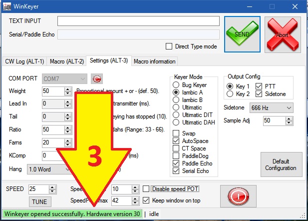

Select the new Winkeyer port in the Log4OM Winkeyer window as in arrow 1 below - Then click the start button identified by arrow 2
You should now see the connection is OK at the bottom of the Log4OM Winkeyer window as indicated by arrow 3 in the screen shot below

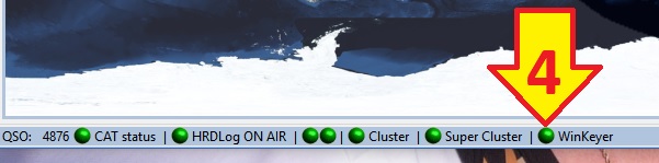

Leave the Winkeyer window open but look on the status bar at the bottom of the Log4OM window and it should show a green dot as indicated by arrow 4 in the screen shot below
w0xxx wrote:I'm not seeing the key icon on the status bar of the logging program.
The icon you refer to is probably an obsolete icon from earlier releases of Log4OM it is now placed in the 'Radio' menu with the selection 'Winkeyer'
