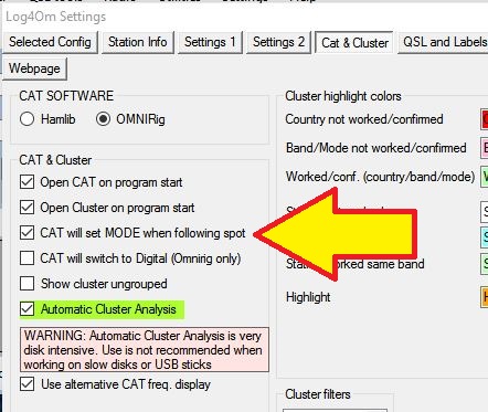

I am new to Log4OM. I have it setup using an IC-7300 with omni-rig. It works fine in changing frequency for instance when I click on a spot. However it is not changing the operating mode. Other than that I am very impressed with the program. I have it working fine with WSJT-X. I have been using HRD and DXLabs but I really like the everything in one place aspect of Log4OM.
Ideas on the mode issue

Did you check this box in Log4OM options?

I figured it had to something simple. That worked and thank you very much
