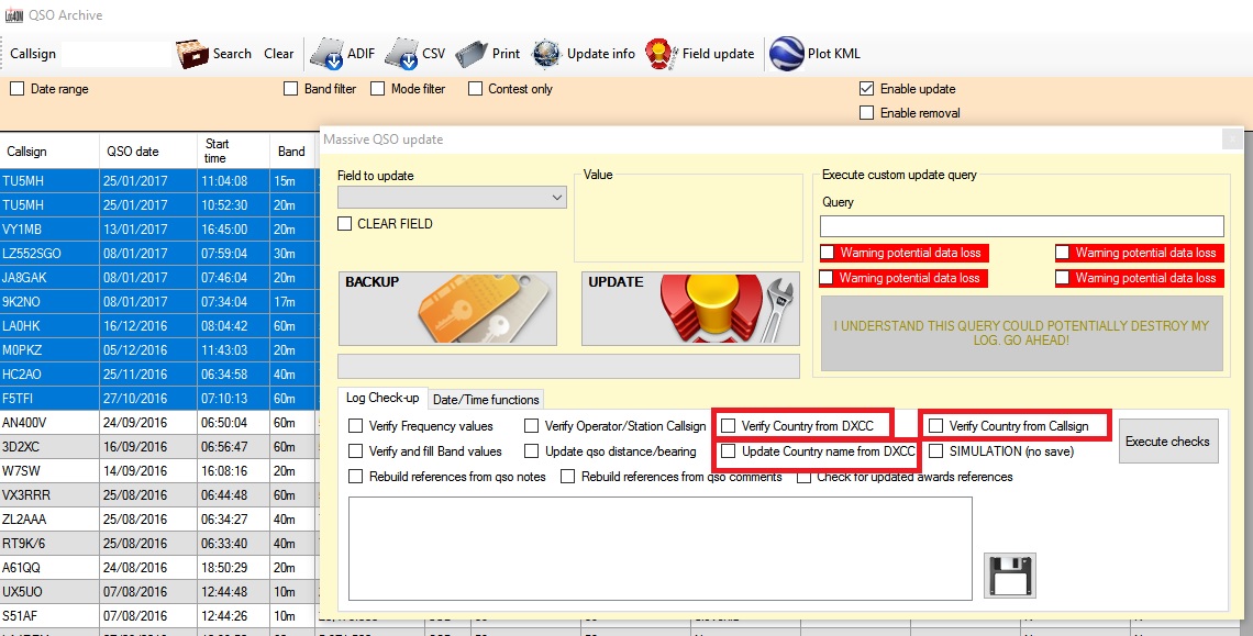

I am trying to enter my old paper written log books to the Log4OM log book. Is there an option to add the "country" field automatically ? This is needed so I will be able to see the worked countries in the streamed cluster info. I managed to see the country by double-click on the call sign in the logbook program under recent QSO, this opened an Update QSO window and after using the Update-Save options the country name appeared in the log. Is there a better/quicker way ?

4X1KP wrote:I am trying to enter my old paper written log books to the Log4OM log book. Is there an option to add the "country" field automatically ? This is needed so I will be able to see the worked countries in the streamed cluster info. I managed to see the country by double-click on the call sign in the logbook program under recent QSO, this opened an Update QSO window and after using the Update-Save options the country name appeared in the log. Is there a better/quicker way ?
Thanks, Dov.
QSO Archive Manager
Use one of the selections highlighted by red boxes below

Terry, thanks for your reply. As a new user of the Log4OM it took me a while to find the windows that are in your answer but after some trials I succeeded to fill the country field.
