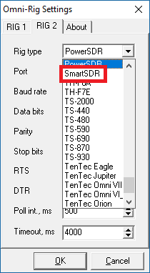

I got it to work by installing OmniRig. That's all there was too it. And as with most of these programs we use TS 2000 as the radio being identified instead of FlexRadio because it works. Guess no one has created one for the flex.

I just discovered this thread, Jose, and could have helped you earlier if I had been active on the forum. Unfortunately for ham radio, including Log4OM, I've been waylaid with other things. Yes, you must run Omnirig. There is not a method yet to use the FLEX SSDR software without it to run Log4OM. You will also find some "missing function" while using Omnirig such as how it handles RTTY reporting to the log, or jumping on a spot. I also think that only a single slice is supported. I believe these will eventually be made to work. Still, Log4OM is a really nice solution.

i don´t know if ther some changes between TS-2000 and SmartSDR in OmniRig but if you download the latest ini Files from the OmniRig download page yo will find also "SmartSDR" in OmniRig. Have seen that when i´ve connected to my Red Pitaya SDR by using PowerSDR so the entry "SmartSDR" is just one entry below.
