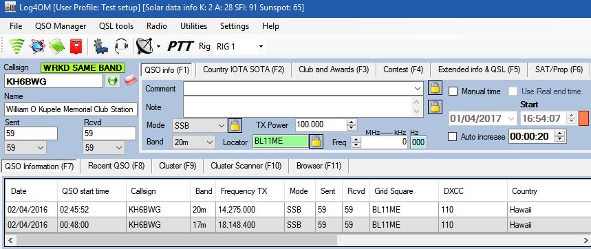

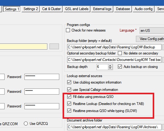

The lookup from an old QSO indicating 'Worked' is functioning fine for me so either the boxes indicated below are not checked or you have a bad download or installation.

I have the boxes highlighted & the "worked/Worked Same Band" comes up now!!
