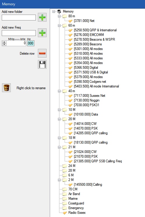

Posts: 11602
Re: CAT direct frequency entry
You could use the Favourites facility (Utilities/Favourites) for some measure of frequency control
