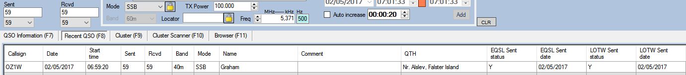

In the Recent QSO List <F8> I see (amongst others) EQSL Sent date and LOTW Sent date. Now is where it gets strange.
EQSL Sent date is 2/05/2017
LOTW Sent date is 1/05/2017
It appears EQSL is using local time but LOTW is using UTC time.

think also that L4O is using the local time for setting the date on eQSL upload date. See attached screenshot.
There are two contacts after midnight local (UTC here 2 hrs behind) and the date for the new day (local) is
used. But not a problem so the date on the stored qso´s in the eQSL outbox is o.K.
