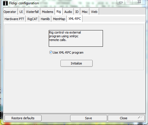

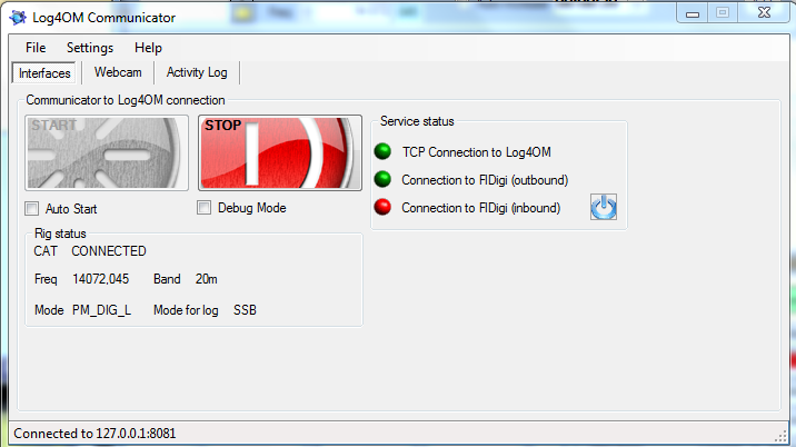

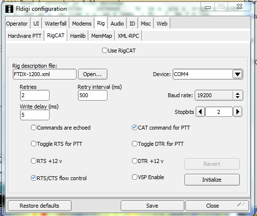

Hi!
Can`t force Fldigi to switch TX/RX:(
QSO`s (manual input) transferring to Log4OM is OK.
Also confused with red indicator for "Inbound" servive status.
Screenshots of setup settings are attached (partly in next topic).
Many thanks in advance!

- Log4OM_communicator.png (75.07 KiB) Viewed 9174 times
- Fldigi_rigcat.png (52.74 KiB) Viewed 9174 times
- Fldigi_xml_rpc.png (48.02 KiB) Viewed 9174 times

The fact that you have no inbound connection (Red LED illuminated) indicates the perhaps you are not running Log4OM as an administrator or perhaps a firewall or antivirus is blocking the inbound route?

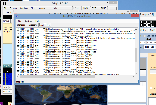

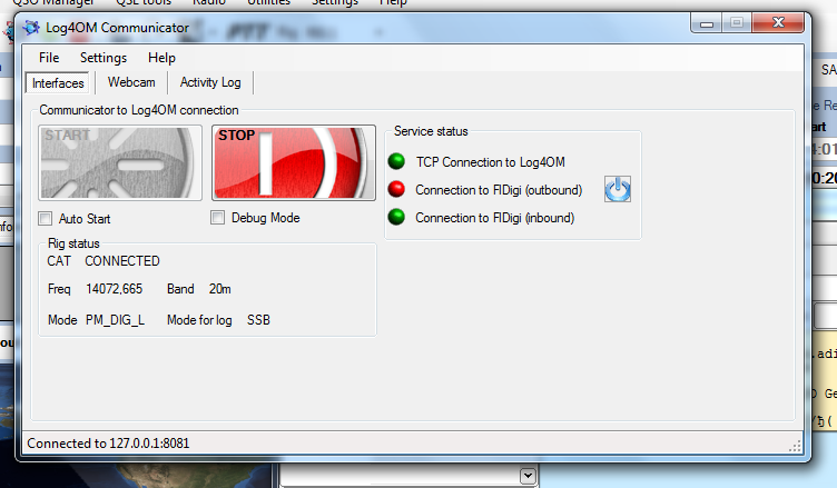

Re: Log4OM&Fldigi
Nothing regarding ports and connections management have found in MS Essentials.
As a precautionary measure stopped the MS Windows firewall.
Got "green" Fldigi inbound conxn, but TX still not working:(
A pair of new screenshots is attached.
As I can see in comm`s log something is wrong with connecting to Fldigi.
Tried to make clear installs of both programs on another computer - got the same thing.
Where to go now - that is the question!:)

- Communicator_main_screen.png (110.66 KiB) Viewed 9142 times
- Communicator_log.png (110.74 KiB) Viewed 9142 times
