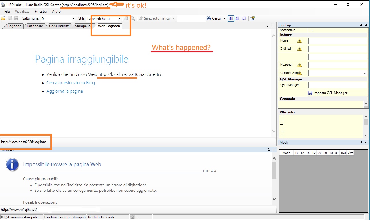

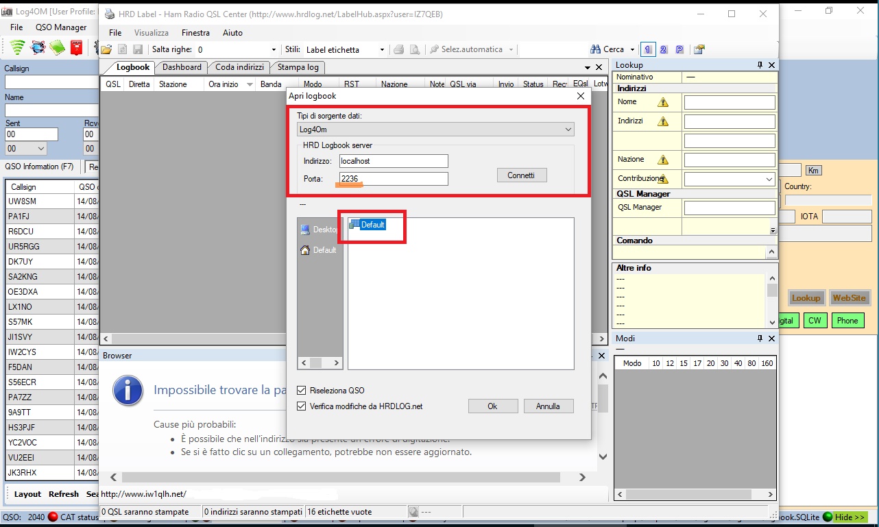

For HRDLabel, in theory there might be a possibility: to take advantage of the UDP port of the "INBOUND SETTING" of the Log4Om Communicator; it's usually 2236, and inserted in the parameters, it manages to read the sqlite log but can not open it.. Attach screenshot ..
73, Angelo IZ7QEB
