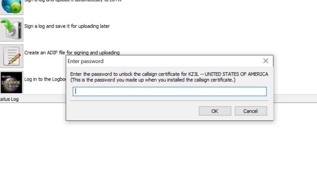

Is it possible to have the LoTW certificate password entered automatically? I get a prompt to enter it every time when uploading QSOs to LoTW.
I did search through the forum and couldn't find this addressed anywhere.
Please see attached image.
TQSL Password Prompt.JPG (54.66 KiB) Viewed 6970 times
Re: LoTW settings
No the private password is a function of the TQSL program for secure signing of the TQ file
Re: LoTW settings
That TQSL password is something you set up with your TQSL installation. You do not have to have that password to make it function.
You can just remove it and you won't be prompted in the future.
