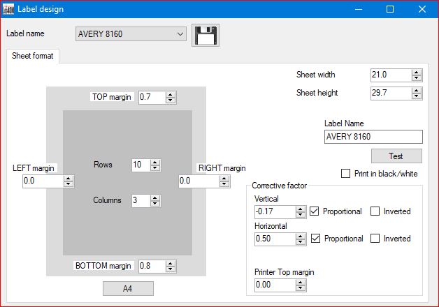

Yes, trying to get the Avery 8160 labels to print here. I have measured and reset numbers many times and it seems nothing is working. Either have everything lined up at top but not bottom or bottom not top. Wondering if anyone else has had this problem? Gone through too many labels and still nothing is working for me. Guess I am saying HELP!

When setting up labels to print don't use an actual sheet of labels until you get things sorted out. Just print to a plain sheet of paper and do an overlay on a label sheet and see how it looks. Saves $$.
I also am using the Avery 8160 labels and did some tweaking to get things lined up. Now my settings may not precisely work for you as it is also dependent upon the printer. In fact I may have to adjust mine a bit as I got a new color printer a couple months back and I've not tried printing any labels since I got the new printer. Your question will have me testing that printer tomorrow morning.
I've enclosed a screen shot of my settings for the Avery 8160.

Hi Nolan, thanks for the info. Yes after messing up couple of sheets I did use just plain paper. I believe my problem is in the vertical and horizontal settings as I can see yours are much different. What a pain, hi. Guess am use to just setting label number and it working out for me, just lazy, hi. Again thanks for the help.

Ron,
I worked on mine until late last night (you got me motivated). The new settings ended up quite a bit different from what I posted from my old printer.
Part of the nuance is that the measurements are metric and that is not quite as common to us here stateside. The form size is also A4 which is a smidge different size than our common 'letter' size.

Terry - The Avery 8160 labels I have (stateside) sit on an 8-1/2x11 page. I would expect that the same 8160 over there would be on an A4 size page.
I've tweaked settings and when I print a test page I have things set reasonably well, but there is still some creep on the lower 1/4 of the page.
I've printed some actual labels and due to font size changes (on callsign), etc.. it tends to creep in larger steps and quicker.

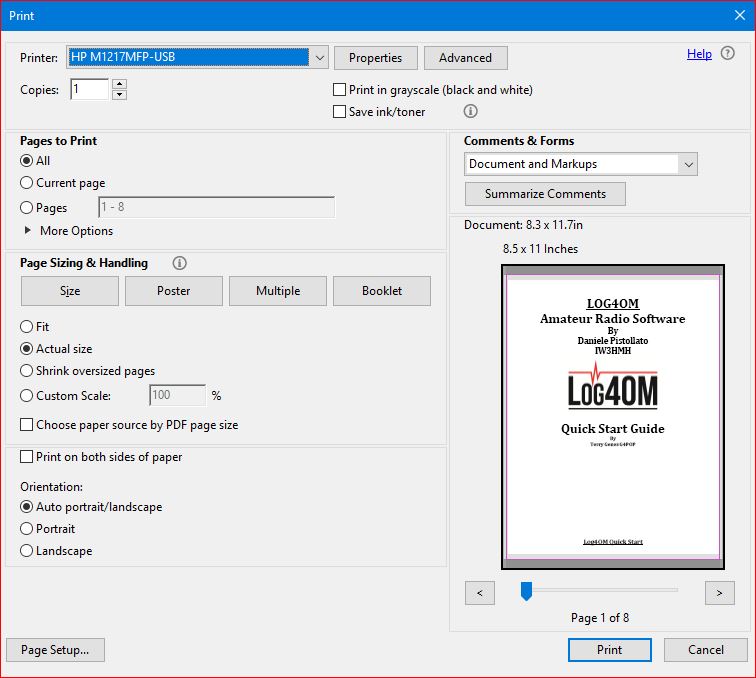

Thanks Terry for the kickstart.
I took the time tonight to wipe a slate clean and start again and got it nailed down.
Biggest thing I came across was a simple click for printing the labels from within the PDF print page and to be sure I selected "actual size" as opposed to "fit".
Makes a big difference.
