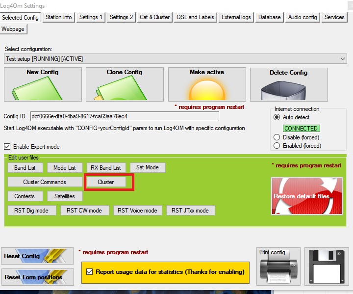

The answer to this is of a three fold nature dependent on what the user requires.
1. The user can add the CW Skimmer telnet port to the list of cluster providers in the F3 Cluster connection window by adding it to the 'Cluster' file accessed via the Options/Select Config. Expert mode as below. This way the user can change from the CW skimmer to any other cluster at will - It is not possible to link this to a specific mode.

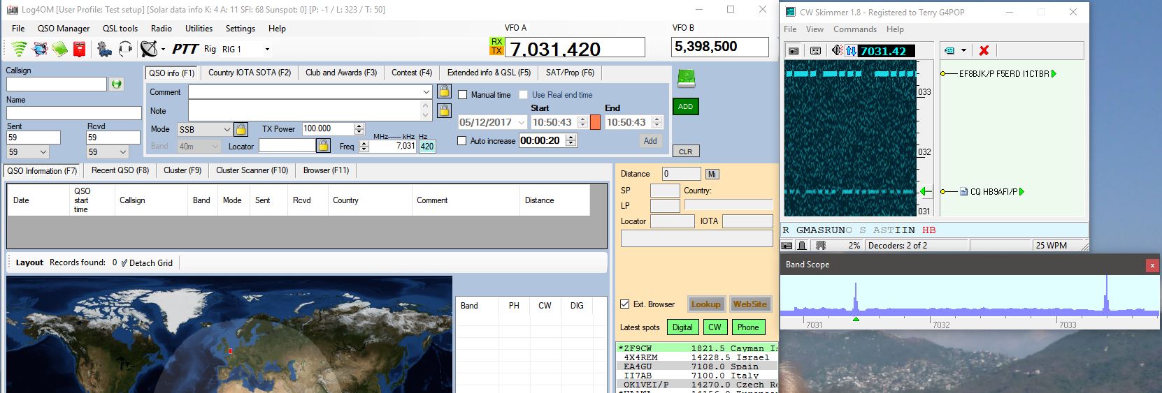

3. Run the CW Skimmer software alongside Log4OM employing Omnirig so that clicking cluster spots in the Skimmer program synchronises Log4OM and the radio for frequency and mode. See screen shot below
