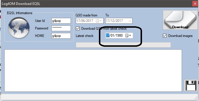

If you do an eQSL download using a very early start date, perhaps the earliest QSO in your logbook, then all will be updated with the latest status

Just tried that Terry but it is like I told, it only downloads the QSLs that are new and not in the archives. Another option would be downloading the complete ADIF from eQSL and merge it with the ADIF that is in Log4OM so far. I think I'll give that a try although I've done a similair thing in HRD in the past which resulted it double QSOs.

Sorry, I just tried to download the complete ADIF from eQSL. I now now what the problem is probabely. I've moved to another QTH in 2008 and so QSOs before are in another account. I guess this will solve the problem. At least I continue to try. Thanks so far for the help...

Hello Juergen, thanks for your reply. To answer the question; my original first account in my main eQSL account. Discovered that it is easy to switch HOME in Log4OM. Problem has been solved. I have to say that I get more enthousiastic about this logbook software every day. However after 10 years HRD it is very difficult to get into new logging software. You get used to some functions and changing software means learning new things. So I'm busy with it...73
