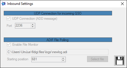

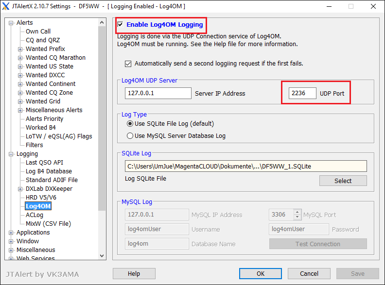

Re: sqkite log
First problerm could be that Log4OM logging is not enabled in the JTalert settings:
second problem could be that UDP Port is different to the UDP port in the communicator inbound settings.
UDP Port in JTalert and in the communicator must be the same ....
Last but not least: Log4OM must be run with administrator privileges ....
By the way, don´t change UDP Port in WSJT-X. It´s on 2237 and that is o.K. so WSJT-X UDP must be diferent to the JTAlert/Log4OM communicator UDP.
NOTE: If you must do some changes please restart all the uses applications in the following order:
First Log4OM
2nd WSJT-X
3rd JTalert
In this order Log4OM has CAT control. If you use Omnirig you can set the Rig in WSJT-X also to Omnirig and you will
have control with WSJT-X too, but Log4OM have alwasys to run first.

Re: sqkite log
Post by kc5nmr »
Thanks for the reply. That really helped. the problem was the udp ports were not the same. Works good now.
