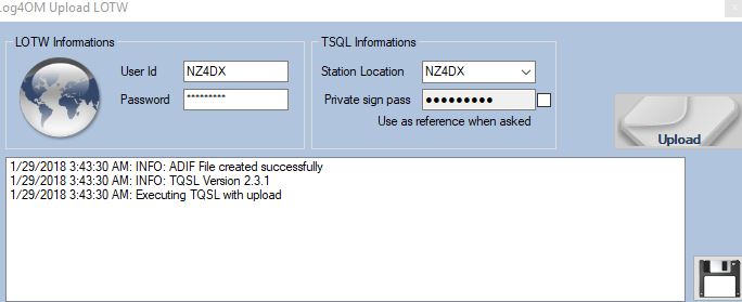

Hey everyone,
I have just switched logging software to Log4OM and was trying to do the first LOTW upload and I get stuck on a step.. I have attached a photo of that spot.. ANy help would be appreciated
73 Fred NZ4DX

did you select the QSO's to be uploaded?

Re: LOTW UPload
Post by NZ4DX »
Yes I selected the qsl's to be uploaded prior to hitting the upload arrow

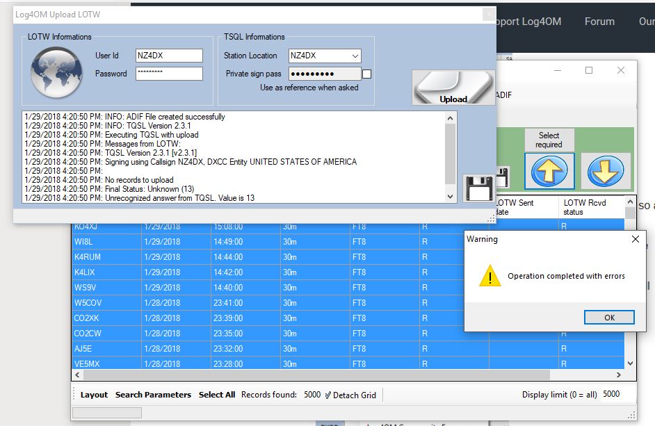

I got a different error this time

The Private Pass Sign password is not normally used. It is not the same as you use for logging onto the LOTW web site. Unless you created one in the CERT process, clear it.
Also, the station location normally is not your call sign, it's normally like DESKTOP, LAPTOP, etc.
Check these and let us know what you find out.

thanks for the reply Chuck.. I cleared out the private password and my station location is set to my callsign.. guess i changed that when setting it up.. still getting the same error

Re: LOTW UPload
Error returned is "13".
This means: The TQSL duplicates database is locked
I think there is something into TQSL (a temporary database) that is locked or TQSL has not been closed properly last time and leaved his internal database opened.
If you check in the TQSL folder (i guess) you should see a file with strange extension like ".tmp" or ".running" or ".working"...
try removing (copying away) this file from the folder and then check if it works.
Another option (last option) is to save certificates and reinstall TQSL.
