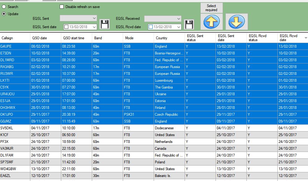

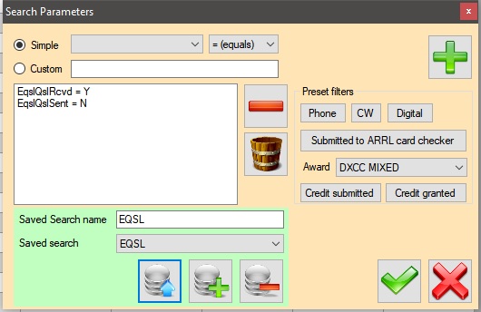

1. I open the Log4OM QSL Manager.
2. Download your eQSLs since my last download.
3. Using the 'Search parameters facility set up a search and save it as in the screen shot below - You will only need to set this up once as it is saved for future recall.
4. Search using the search parameter that you have set up
5. Click the title at the top of the eQSL received column to arrange the dates in descending order
6. Highlight those QSO's for the date of those last downloaded (Clearly my screenshot shows all of my QSO's have already been uploaded)
7. Click the 'UPLOAD' arrow - Those eQSL's will be uploaded and also updated to sent in your logbook
This process reduces your required actions somewhat.
