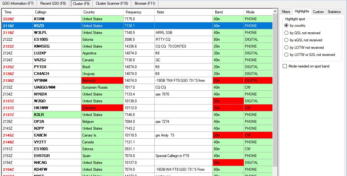

Is it possible to set up the cluster to highlight countries that have been worked, but not confirmed yet? I have it set up to highlight unworked countries in red, but would like to distinguish between countries that I've worked and not confirmed yet and countries that I've worked and confirmed.
The "Cat & Cluster" setup tab has a highlight color item for "Country not worked/confirmed", and this does highlight countries that I haven't worked, but it doesn't highlight countries I've worked, but not confirmed.
Posts: 11586
Re: Distinguish Between Worked and Confirmed in Cluster?

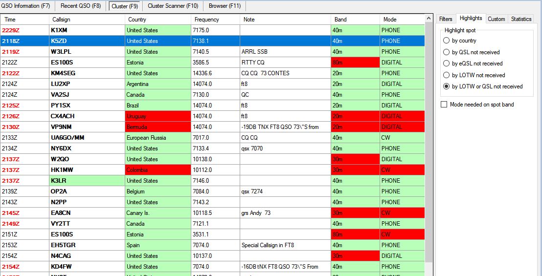

Quiet simple really! just use the 'Highlights' tab in the cluster to select
Worked or Not confirmed by QSL or LOTW - See examples below that vary by highlight selection - You will note its the exact same cluster spots but the highlighting has changed as you described!
