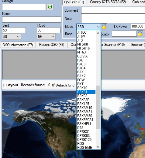

Using BPSK I can not select PSK as the mode and BPSK31 as a submode. When I push ADIF files to other loggers I have to manualy adjust these two fields to get QSO records to match. Could an enhancement be made to have MODE and SUBMODE support? &3 Sam KI7AAY

My mistake. I am referring to PSK (Mode) and PSK31 (submode)
Does that help. ?

I have to be missing something here because we already have that and have done since the change to mode and submode in ADIF a couple of years ago!
Here is an ADIF I just exported for an old PSK31 QSO which clearly shows mode and submode
# Log4OM by IW3HMH version 1.30.0.0
# http://www.log4om.com
# created: 22 August 2017 UTC
<ADIF_VERS:5>3.0.4 <PROGRAMID:6>Log4OM <PROGRAMVERSION:8>1.30.0.0 <eoh>
<ADDRESS:41>Kopitarjeva 3
Brezice
8250
Slovenia <ANT_AZ:3>114 <BAND:3>20m <CALL:5>S58BO <CONT:2>EU <COUNTRY:8>Slovenia <CQZ:2>15 <DISTANCE:4>1259 <DXCC:3>499 <EQSL_QSLRDATE:8>20170522 <EQSL_QSLSDATE:8>20170522 <EQSL_QSL_RCVD:1>Y <EQSL_QSL_SENT:1>Y <FREQ:9>14.071324 <GRIDSQUARE:6>JN75tv <ITUZ:2>28 <LOTW_QSLSDATE:8>20170522 <LOTW_QSL_RCVD:1>N <LOTW_QSL_SENT:1>Y <MODE:3>PSK <SUBMODE:5>PSK31 <MY_CITY:17>XXXXXXXXXXXXX <MY_CNTY:7>England <MY_COUNTRY:7>England <MY_CQ_ZONE:2>14 <MY_GRIDSQUARE:6>XXXXXXX <MY_ITU_ZONE:2>27 <MY_NAME:5>Terry <MY_POSTAL_CODE:7>XXXXX <MY_RIG:11>Icom IC7600 <MY_STREET:16>XXXXXXXXX <NAME:5>Bojan <OPERATOR:5>G4POP <OWNER_CALLSIGN:5>G4POP <STATION_CALLSIGN:5>G4POP <PROGRAMID:6>Log4OM <PROGRAMVERSION:8>1.30.0.0 <QSL_RCVD:1>N <QSL_SENT:1>N <QSL_VIA:22>Bureau, direct or eQSL <QSO_DATE:8>20170522 <QSO_DATE_OFF:8>20170522 <QTH:7>Brezice <RST_RCVD:3>599 <RST_SENT:3>599 <RX_PWR:3>100 <TIME_OFF:6>142446 <TIME_ON:6>142446 <TX_PWR:2>40 <LAT:9>45.903000 <LON:9>15.596100 <PFX:2>S5 <SFI:1>0 <CLUBLOG_QSO_UPLOAD_DATE:8>20170522 <CLUBLOG_QSO_UPLOAD_STATUS:1>Y <HRDLOG_QSO_UPLOAD_DATE:8>20170522 <HRDLOG_QSO_UPLOAD_STATUS:1>Y <QRZCOM_QSO_UPLOAD_DATE:8>20170522 <QRZCOM_QSO_UPLOAD_STATUS:1>Y <APP_LOG4OM_VALIDATED_CALLSIGN:1>Y
<APP_LOG4OM_MANUAL_DATETIME:1>N <APP_LOG4OM_MOBILE:1>N <APP_LOG4OM_QRP:1>N <APP_LOG4OM_PORTABLE:1>N <APP_LOG4OM_MY_ANTENNA:14>140 ft Doublet <APP_LOG4OM_CONTEST:1>N <EOR>
