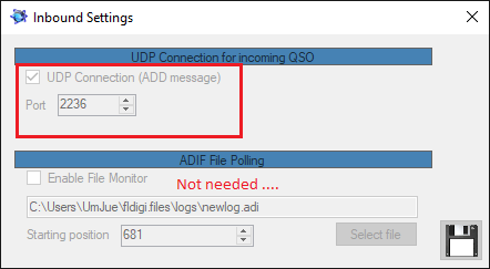

That's not how JTalert sends qso's to Log4om, it's not by polling the ADIF file, check the JTalert documentation for correct set up!
Re: JTalert: QSO to Log4OM (mySQL)

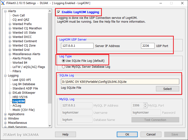

In the Log4OM communicator "Inbound Settings" UDP must be enabled and the UDP Port must be the
same as in JTAlert (normally 2236 for both). Logging to Log4OM must be enabled in JTalert. In JTalert
you have to set the correct path to your SQlite File.

Hello Jürgen, I'm not using SQlite but mySQL
PA0AER wrote: 01 Apr 2018, 10:33 Hello Jürgen, I'm not using SQlite but mySQL
If you base that assumption on the JTalert message it's an error of JTalert fixed in yesterday's release.
If you really are using mySql then use the fields marked mySql in the screenshot provided by Juergen instead of the Sqlite ones

I have used that settings for MySQL, except de UDP port, in my case is that 2237 (and 2236 for communicator)

Juergen says that the DIF filepolling is not needed, but when I uncheck that, log4om doesn't log anymore.
