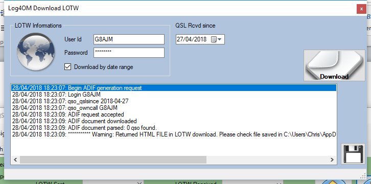

I have been using QSL Tools/QSL Management very successfully for uploading new QSOs and downloading new QSLs from LoTW but a few days ago the download produced an error and I’ve not been able to correct it. The only changes I have made was to the LoTW password but that doesn’t seem to have had any bad effects and the error message looks like login to LoTW was successful, it just seems that Log4OM doesn’t like what LoTW supplies on download. Checking on LoTW, there are new QSLs to download so maybe I have broken something. A screenshot of the error message is attached.
Screenshot 2018-04-28 19.24.41.png (38.64 KiB) Viewed 3081 times
Grateful for any thoughts or suggestions as to what might be the problem.
TNX and 73
Chris G8AJM

What version of Log4om are you using
Your password must not contain special characters like @#$%^&*()!?"+×÷=/_€£ etc

Hi Terry, I'm using 1.32 and yes I do have some of those characters, I got the password as a result of requesting a new one from ARRL. I guess I need to find out how to change it manually and give it a go with a simpler pw.
Many thanks
Chris G8AJM
Re: LoTW QSL download problem
Yes you do because that will most likely be the problem

Spot on!
Many thanks Terry.
73 Chris G8AJM
