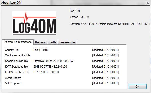

today I've test to run Log4OM with always same result ...
in one attemp, before program stop, I've gained the "setting/option" menu then found any selectable configuration was present and only new configuration was available then I create a new one, opening my old Database and all was running again (with all setting as dafault).
after I've tried to update on "setting" menu, the IOTA, Sota, Country and all database pointing the default selection (i.e. external web site, RSGB web site etc) and again program fails and close. One time more opening program, due the last action performed before stuck, I've open help/about finding the date situations as attached.
anyway, this time I've created the trace for bug report and I will send it as requested.
best 73 Paolo

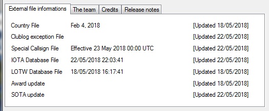

Re: Log4OM stop to running FIXED
Used Log4OM for many time with pending problem, running only without performing any database update through setting menu. Then found the blocking cause with Clublog and IOTA database update.
Also full unistall and reinstall of 1.31 or older version had notsolved while the latest version required a system update and the time availability to perform it. Finally installed the atual v1.32.0.0 and all seems working as expected: the date showed on each database is current.
Thanks Terry for help. best 73, Paolo
