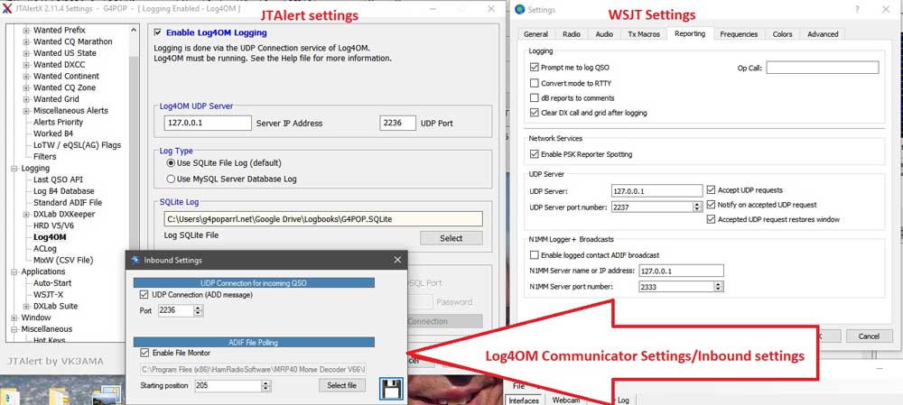

Since updating to v 1.33.1.0 I have not been able to automatically log an FT8 QSO made in WSJT-X. I have checked all the settings and everything appears to be aligned with the manual and as set-up previously.
Has this been observed by anybody else and if so have you found a solution?

You should be checking the settings in JTAlert or Gridtracker because it is one of those that logs to Log4OM

Thanks Terry. Yes, I have checked those settings in JTAlertX and everything seems correct.
I don't seem to have found a way to test the connections process without generating dummy QSOs - probably because of my limited knowledge of this area.

Perhaps this will help
Re: FT8 Log entry via WSJT-X no longer working
Also are you CERTAIN that you installed Log4om to 'run as an administrator ' as in the user guide page 9.?

Hi Terry - I've been away from this problem for a while. Yes, both programs are installed as administrator and all settings appear to be correct. Clearly they are not, and as others are not howling its clearly something local to me :-)
I will get to the bottom of it.

Are you saying that JTAlertX is set to run as administrator? It doesn't need to be, nor does WSJT-X. Could that be the problem?
