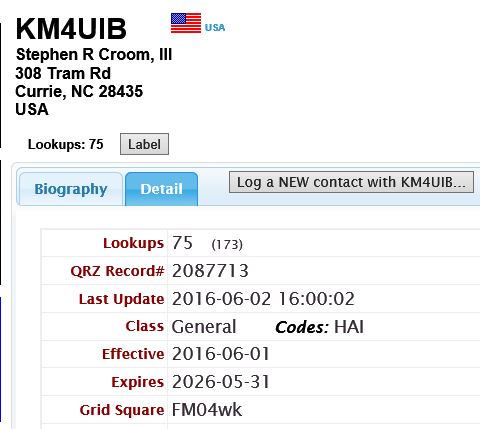

The grid locator that KM4UIB has registered to QRZ is FM04WK so HRDLog is correct in highlighting an error!

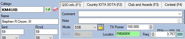

Typing KM4UIB into Log4OM correctly provides FM04WK as a grid reference.

I traced this down by monitoring the network traffic going to hrdlog.net
Log4OM is sending the correct grid. HRDLOG is somehow sticking in this EM19FA for some odd reason. I've reported the problem to them.
