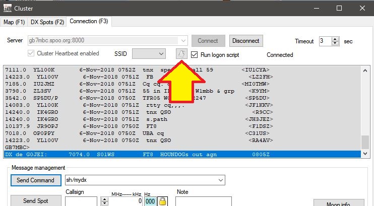

In the F3 Cluster connection screen uncheck the "Run login script" and then click on the script icon as indicated in the screen shot below
The resulting window allows you to modify the login script - Don't forget to save it and recheck the box before restarting the cluster

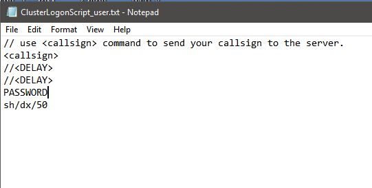

Re: How to add password to cluster login
Picture got lost when we changed server some time back, I have replaced it as best I can but here is the resulting window
