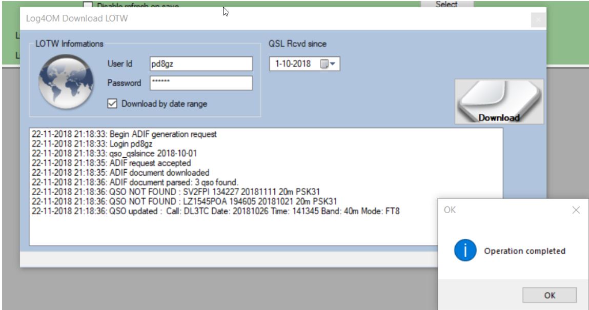

I have although a question...i'm using LOG4OM version 1.34.0.0 and i'm trying to download LOTW and eQSL logs into LOG4OM.
When i do this some qso's give's an error message: 'QSO Not Found...'. This is very strange because they are confirmed qso's.
Sreenshot of the messages:

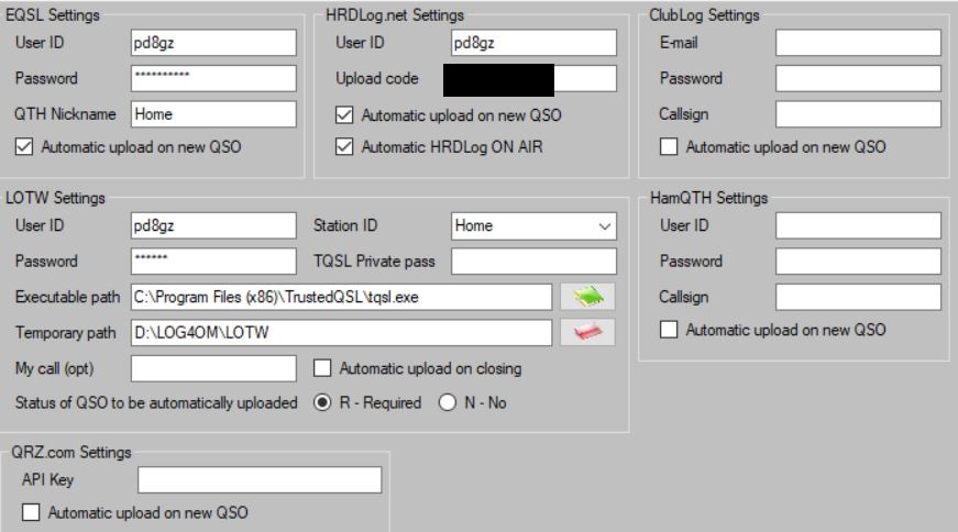

The settings in LOG4OM are:
I'm also using the latest version of TQSL, all the passwords and username's do not contain any 'special characters'.

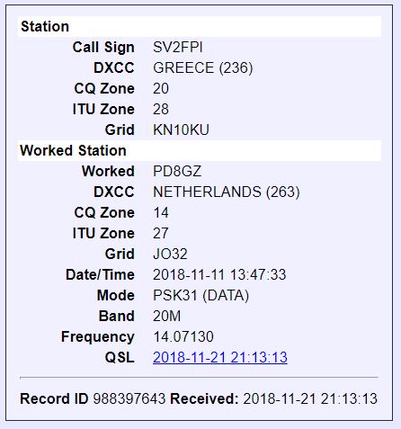

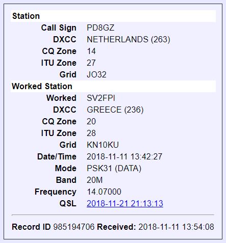

The QSO's seems to be oké....except time and frequency.
Here are the screenshots: Thank you.

Clearly if the time and frequency don't match then the download from QRZ will treat the qso's as different qso's and the result is QSO not found!
