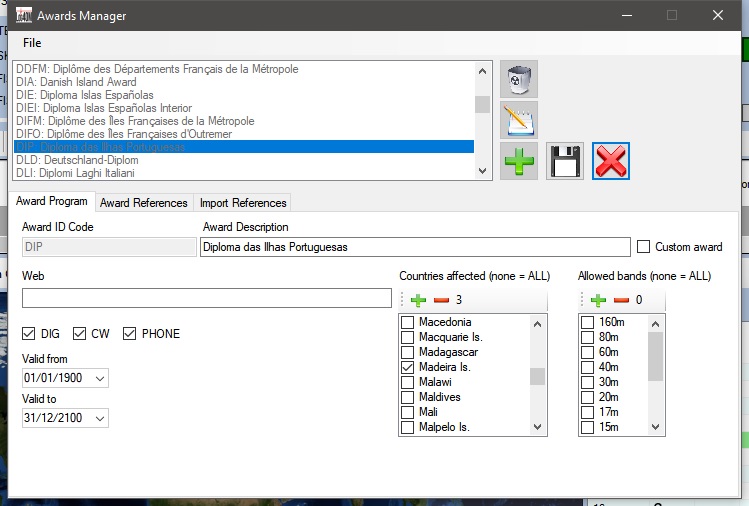

If you view the full DIP listing, it includes Madeira and Porto Santo Islands (both in my log) But when I go into the log entry to add the island, I can't select the islands award. ARLHS, WFF, WLOTA all there DIP is not. I know the process as all my CT and CU islands have already been manually entered using this method.

Ian,
I checked this and there is an error in the award
1. Go to Utilities/award manager
2. Select the DIP award from the list
3. Click the edit button (Looks like a pencil on a notepad)
4. In the countries list check the box by Madiera Is
5. Click the save icon (Looks like a black floppy disk)
6. Close the awards manager

Re: Madeira - Portuguse Islands Award
Thanks Terry
One more step after that....
click on the "Award References" tab and edit the five Madeira islands and change the DXCC from 272 to 256 otherwise there are still no islands to choose.
Save at the edit islands section and edit award section !
Here is the corrected file for import into the awards manager
