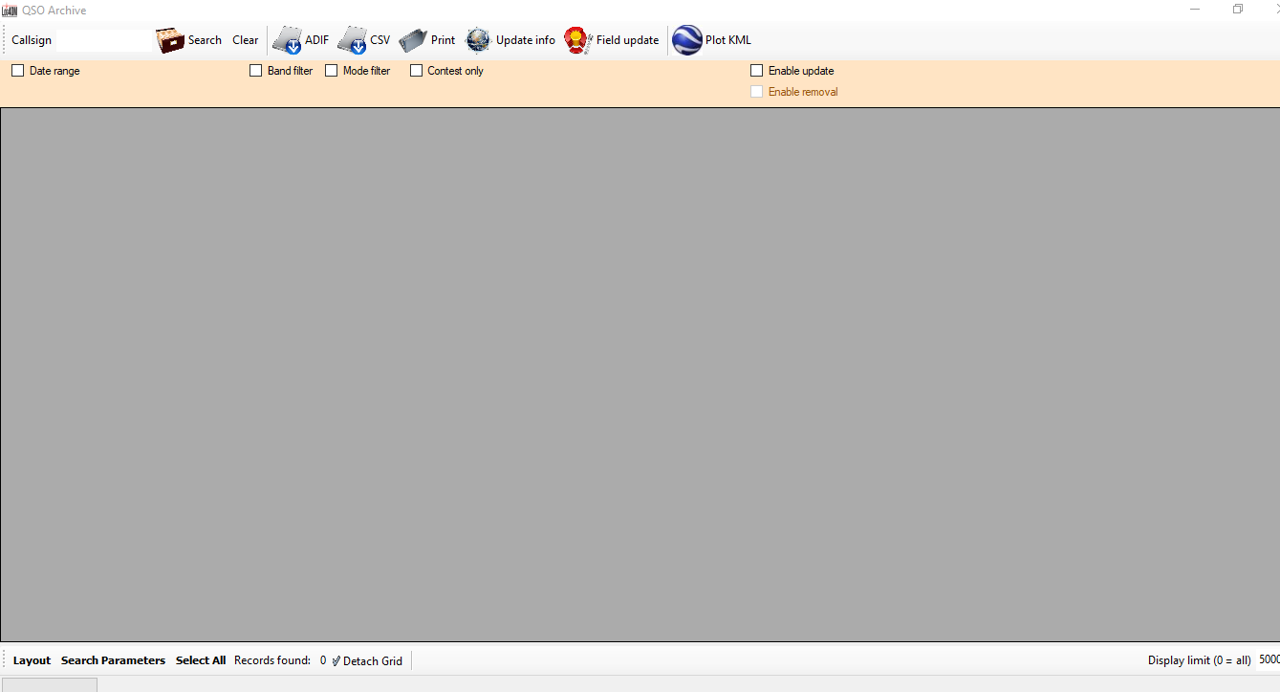

Thank you for your quick reply. The answer is yes. I clicked on the serach button but no QSOs display.
And "Records found: 0"

You must have a filter applied or perhaps something in the call sign field, please post a screen shot

It seems that there are no filters.

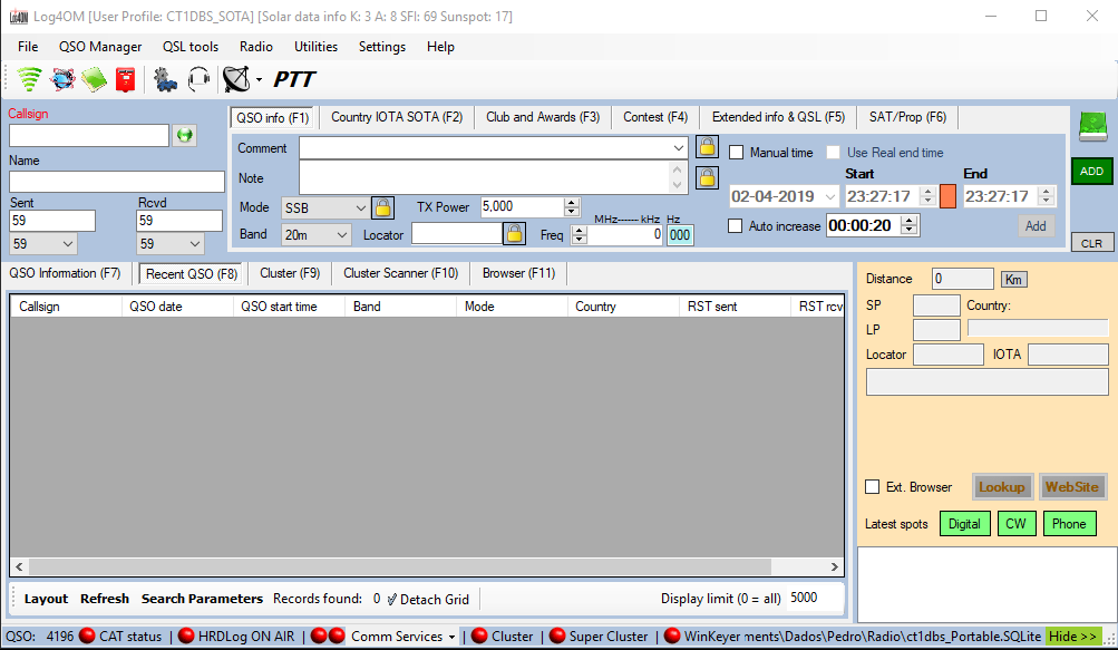

Can you see the qso's in the Recent QSO window?

Please post a screenshot of the Recent QSO window

I attached the print screen.

Posts: 11569
Re: Error in QSO Archive
Problem solved!
There was a comma in one of the frequency fields, like 5,000 instead of 5.000
