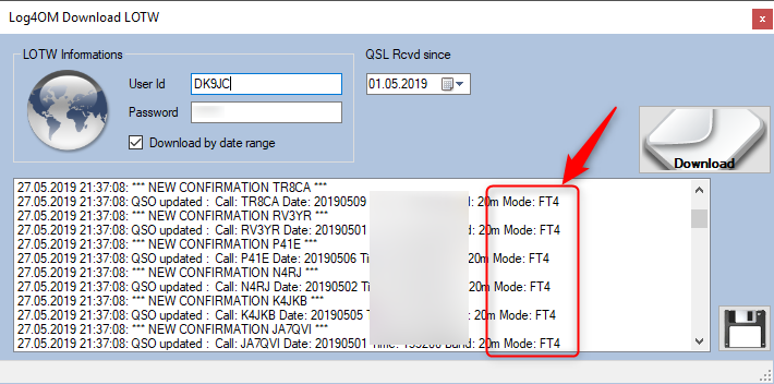

Hi forum,
when FT4 was new I just added FT4 manually in my modelist. That was ok to log my QSO via JTAlert and WSJT-X automatically.
Now, with the new TSQL I can upload those QSO to LOTW. I see those matched on LOTW when I log-in on the website but can not download / sync the QSLs from LOTW.
I always get
DATE/TIME "QSO NOT FOUND" : CALL TIME DATE 20m MFSK8
Any ideas how to fix that issue? I use 1.37.0.
modelist: FT4 FT4 MFSK FT4
ModeList_user: FT4 FT4 FT4
I saw the post "If you patched modelist or added modelist_user please remove it as FT4 should be logged in ADIF 3.x as MFSK / FT4".
When I removed the whole line "FT4 FT4 FT4" in ModeList_user the mode FT4 was not there in the programm anymore.
Any help would be highly appreciated.
73 John DK9JC

G4POP wrote: 27 May 2019, 07:48 You should also DELETE the mode list user file to enable the new default mode list file to work
OK, did not delete the whole "ModeList_user" file. I just deleted it now and I was able to download the LOTW QSLs.
Problem solved. Thank you for the support. :ugeek:
