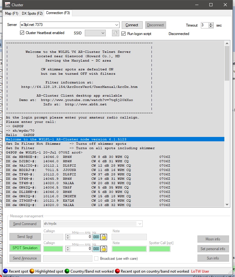

I am sorry but I fail to see the issue it works fine for me!
This is my login script
// use <callsign> command to send your callsign to the server.
<DELAY>
<callsign>
sh/mydx/70
I always use one delay because so servers are slow but as you can see from the screen shot it works 100%
BTW dont comment that the cluster was disconnected I had to stop the cluster to take a screen shot of the login section
