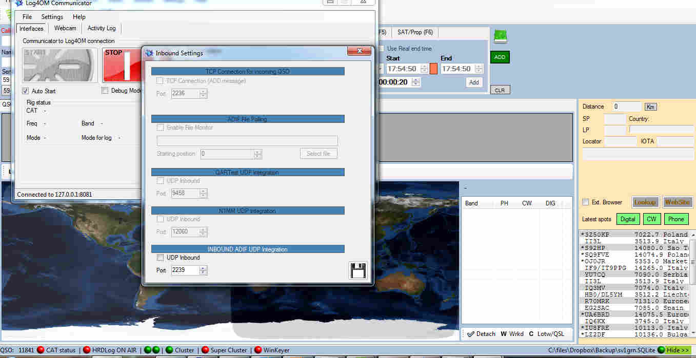

Hi dear friends I'm trying to use adif polling with green tcp connection but,inbound settings are not active. I am using it as admin and have win 7 prof 64. Please see the photo any help? 73

Read the user guide, you must STOP the communicator, set inbound settings then restart the communicator.

Thanks ok, what is the starting position question about? In page 25 I didn't find any mention 73

Starting position in the adif file.
zero = The first character, so setting to zero will collect every qso from the file, etc
