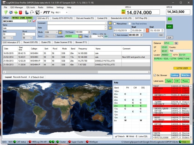

Log4OM can show previous QSO (realtime) only with a Call in the Callsign field of Log4OM himself. If you log from
3rd party like JTDX and/or via JTalert Log4OM only waiting for a ADIF inbound message. If it receive
this the QSO will be logged to the Database and no previous contact could be show´n in realtime.
Best is to use JTalert and hold it up2date (Logscan from time to time) and it will be show´n the Call
as B4 when you worked on the same band in earlier times.
I can ask Lele it´s possible in the future or not but i think it´s not ....

In version 1 of Log4OM you will only see the worked before list if you enter the call sign manually into Log4OM, the call sign field is not populated automatically by WSJT or its derivates.
We are currently exploring the possibility of automatically populating the call sign field from WSJT (I assume JTAlert is the same UDP system) in Log4OM Version 2
