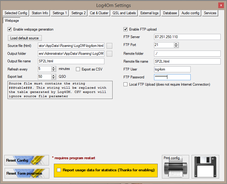

Today morning, looking at the error message logged in vsftpd.log file on my server
Sat Oct 12 12:46:13 2019 [pid 19025] [log4om] FAIL UPLOAD: Client "78.88.244.96", "/SP2L.html", 0.00Kbyte/sec
all of the sudden one thought crossed my mind:
string "/SP2L.html" is pointing to main (root) directory of the Linux system,
not to home directory of authorized local system user connecting via FTP!!!
Therefore smart (Hi!) Linux system did not allowed to upload anything at all!
Bingo! Last not least, issue solved and lesson learned, Hi!
The solution is shown on the attached picture.
It was enough to put "./" in "Remote folder" field.
