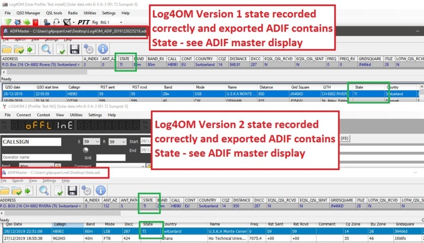

Clearly there is something wrong with the file your trying to import, I just made an ADIF export from Swisslog and also from DXLabs suite with state included, I then imported those files into Versions 1 and 2 of Log4OM and in both cases the state (TI) was displayed.
I then exported those QSO's from Log4OM Versions 1 and 2 as an ADIF file, when viewed in ADIF master and note pad both included the correct state information.
See this composite screen shot showing the Log4OM version 1 and 2 recent QSO records and also the ADIFMaster result
Here is the exported ADIF data

G4POP wrote: 28 Dec 2019, 23:14 Marco,

Re: ADIF Import: use STATE field for regional Administrative subdivisions
For DXlog.net users: adding this
ADIF_KEYS=STATE;$VALUE.RecInfo.Substring(0,2)
to the contest definitions file will create the STATE entry in the ADIF file, it can then be imported into Log4OM
Marco HB9CAT
Marco HB9CAT
