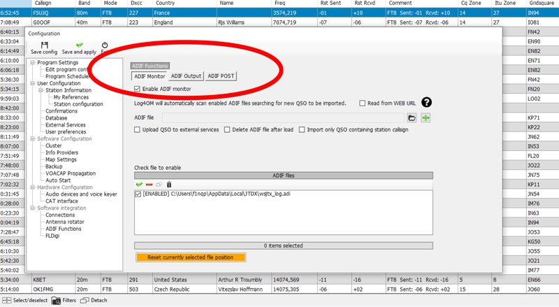

Since JTDX doesn't work with the usual UDP option at the moment, I've been looking for another solution.
My English being approximate, I think I understood that with the "ADIF Functions" option, LOG4OM2 is looking for the new adif qso, and that it imports them.
I just tried, and when I make a new qso with JTDX, it doesn't appear in LOG4OM2.
I did nothing else, but specify the path to the JTDX adif file, and check the "Enable ADIF monitor" checkbox. (see my screenshot)
Am I right or am I wrong?

Re: ADIF FUNCTIONS ??? can replace UDP for JTDX?
Are you sure you have the file being used by JTDX because it works for me and the rest of the alpha team

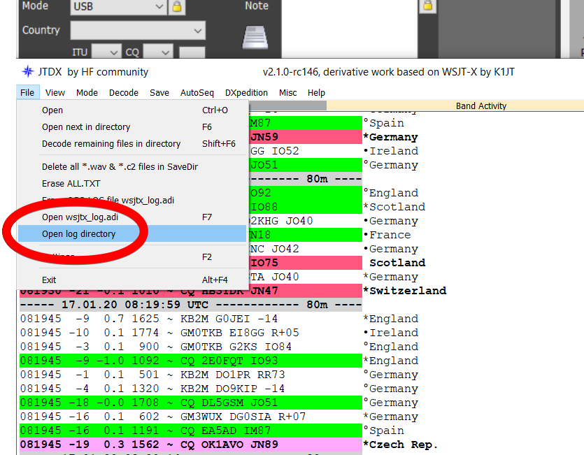

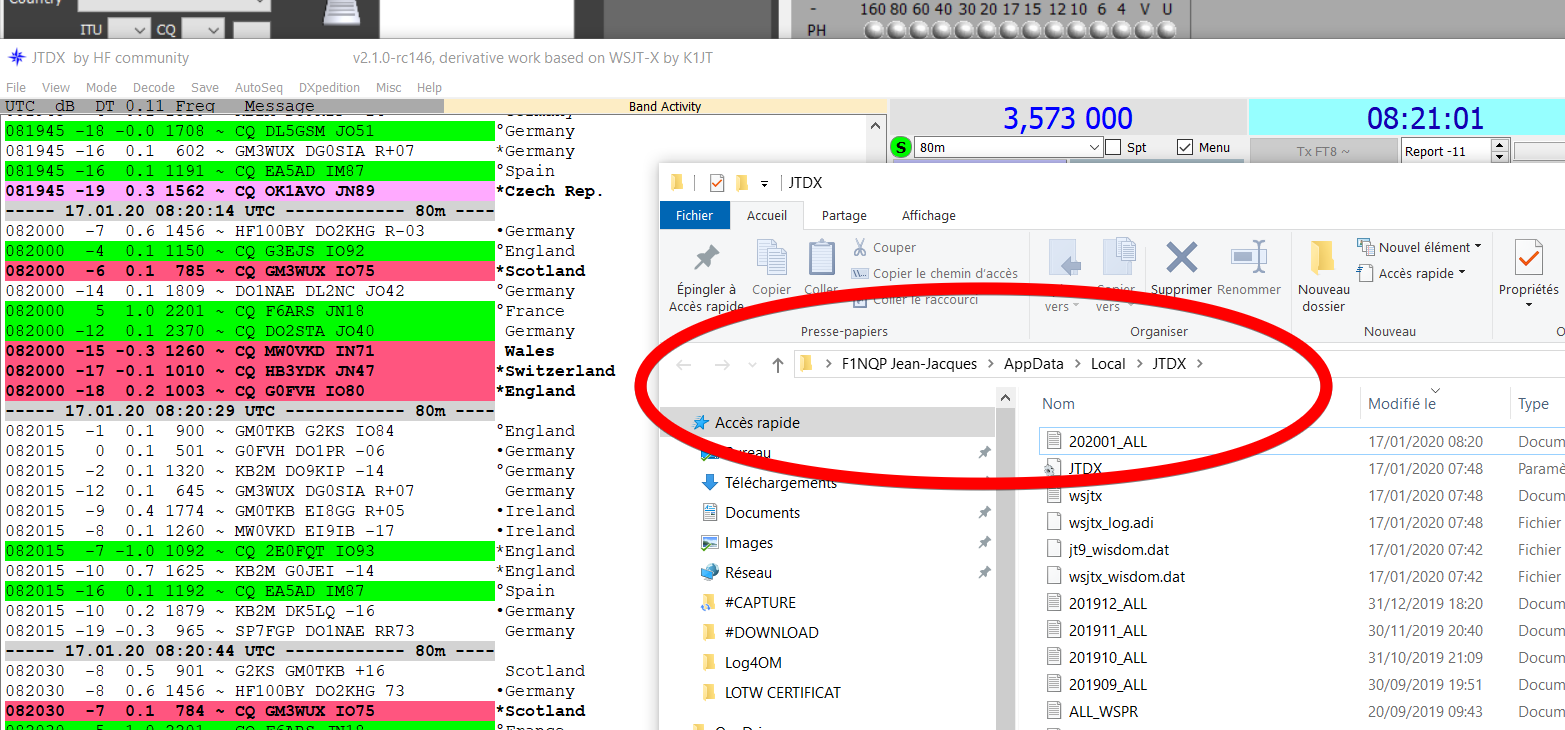

Yes ... I just checked the path to the ADIF file is the right one.
In the JTDX menu, there is an option to view the path to the ADIF file.
I just checked the content of the adif in question, and the qso I just did in 80M is there.
So if the "ADIF FUNCTIONS" options are well configured, LOG4OM2 should have imported the qso.
There's nothing else to do but to check the option reported in my main post, and put the path ?
look at the screenshot.

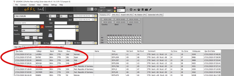

Sorry... it's OK, it works.
I was used to LOG4OM1 and UDP, so it's almost instantaneous. With LOG4OM2 and the ADIF import, there is a latency that disturbed me.
But it works and that's good.
Thanks again to everyone.
(see screenshot)
