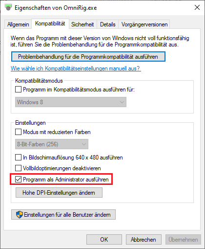

Checking is easy and you´re safe. Here also all is working fine if all programs are run as administrator.
I have a german W10 pro 64 bit but if you go to the .exe files of each program with mouseover and right
mouseky the properties will be open up. Check the compatibility tab and take a look to the "Run as
Administrator" checkbox. My properties window is german but the english one should be equivalent.
Here all is fine with L4O V2 + JTDX + Omnirig. ;) ;)
B.t.w. the Omnirig.exe you´ll find in a folder called "Afreet/Omnirig"

DF5WW wrote: 21 Jan 2020, 16:08 Checking is easy and you´re safe. Here also all is working fine if all programs are run as administrator.
Jurgen,
As I was writing to confirm that all that was OK, I thought: Why not check it again?
To my 'surprise', JTDX was not running as an administrator. I was sure I had changed that. But then it clicked: I'm a JTDX beta tester. Every time there is a new release I re-install the package. There was one this morning, and I did a fresh installation, so the setting was gone.
All is fine now, working like a charm. Live and learn.
