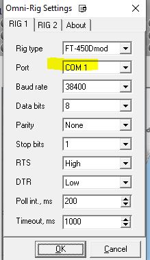

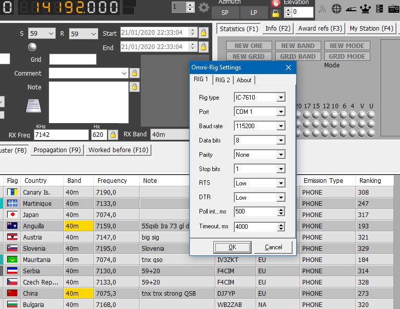

omnirig-log4om settings
omnirig
omnirig

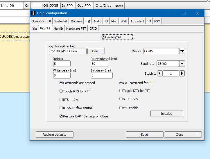

FLdigi settings
Max IK0TIX

IK0TIX
Posts: 91
Joined: 26 Mar 2016, 06:41
Re: Help with V2 and Fldigi
Post by IK0TIX »
Hi Roger,
I will try to be clearer.
For frequency and mode Log4OM already speaks with FLdigi:
- in FLDigi Configure-Rig comtrol you must select flrig. Addr 127.0.0.1 port 7362 (for example)
- in Log4OM Settings-Configuration-FLdigi the same settings and (port 7362) and select start service
- always in Log4OM Connect-FLDigi-connect
- launch FLDigi
Now you should see the same frequency.
The problem now is to send it in TX because the COM port is occupied by Log4OM.
To overcome this problem, the COM port must be split either with the system indicated by Roland HB9VQQ or with a program with the splitter for example Win4ICOM (I have an ICOM but there is also Win4YAESU).
If you use Win4ICOM, it will speak to your rig and it will divide the commands for both Log4OM and FLDigi TX included (splitter)
Max IK0TIX
