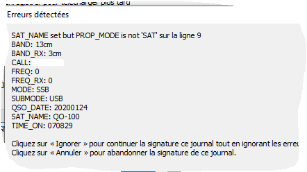

i meet always a prob everytime i try to upload with this msg. I put propagation = satellite may be its a probléme ?

Clearly an issue in the record being sent by tqsl because that is an LOTW message, have you asked on their user group.
You could try removing that QSO before the next upload that would isolate the issue

yes good idea Terry but it does me on 3 qsos in a row. I exported in adif, launched tqsl it does the same thing indeed the problem comes from Tqsl not from log4om.
