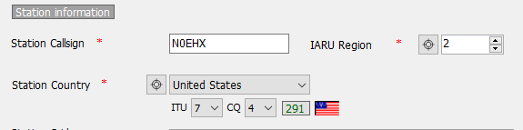

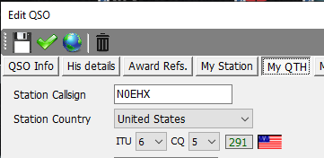

I've noticed using v2.1.0 (and prior) that there are circumstances that cause MY ITU and My CQ zone to be entered into a QSO different than what is setup in Settings for your station. Here's some reproduction steps.
1. Verify ITU and CQ Zones in Settings for your station. In my example it's ITU 7, CQ 4 (See Capture 1 attached)
2. Enter a new QSO via the main screen. Use QSO Manager to verify the My ITU and My CQ cells contain the right data (ITU 7 CQ 4).
3. Double click on the QSO to Edit it and click on the My QTH button. You'll see that it's now ITU 6 and CQ 5 (incorrect) (See Capture 2 attached)
4. Save the QSO, and the incorrect data is now part of the record.
Issue is reproducible without fail, on every QSO (entered direct or imported).
Happy to provide more information if necessary.
73, N0EHX

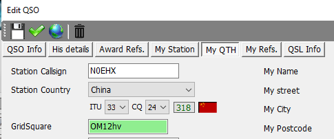

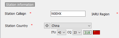

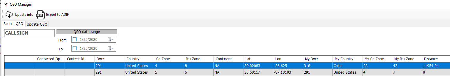

Decided to take it that one step further, just for data points.
Made my Station Country China (just picked something big). ITU 43, CQ 23 (randomly picked)
1. Enter new QSO from main screen
2. Verify in QSO Manager that My ITU and My CQ showed 43 and 23 as setup.
3. Doubled clicked on the QSO, edit window, My QTH and it's showing ITU 33 and CQ 24.
Attached some more screenshots of the test.
- Capture3.PNG (13.59 KiB) Viewed 4595 times
