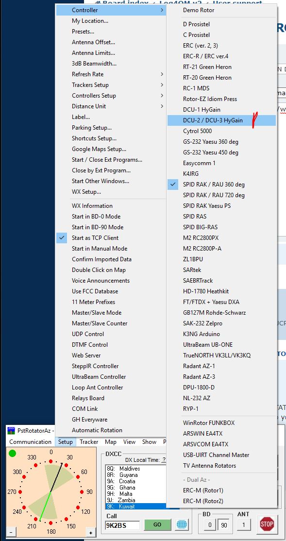

Hi Howard, I highly recommend PSTRotator https://www.qsl.net/yo3dmu/index_Page346.htm. Your DCU-3 is supported.
Also Log4OM supports PSTRotator, pls consult the Log4OM Manual for details.

Thanks so much for your input. Just a few questions.
1) PstRotator or PstRotatorAz…. which do you recommend.
2) I noticed in your rotor selections you indicated spid rak 360. not sure what that is. I have a HAM IV ROTATOR.
3) When I select a contact from the Cluster will it rotate the antenna to the information provided within the cluster?

Hi Howard,
think the Spid rotator is the one that Roland is using but he has marked the one that you have to setting up
for your controller (DCU2(DCU3).

Hey Howard,
PstRotator is for Elevation AND Azimuth , PstRotatorAZ is for Azimuth only.
In my Station setup I am using an SPID RAK Rotator http://spid.net.pl/en/591-2/, notice the checkmark on the left.
Yes absolutely, that's how I am using it.
