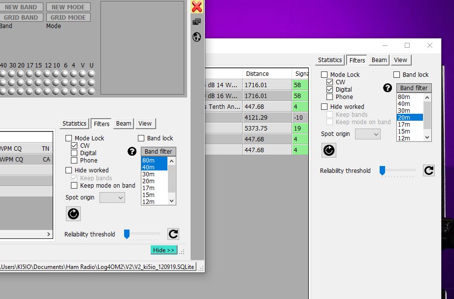

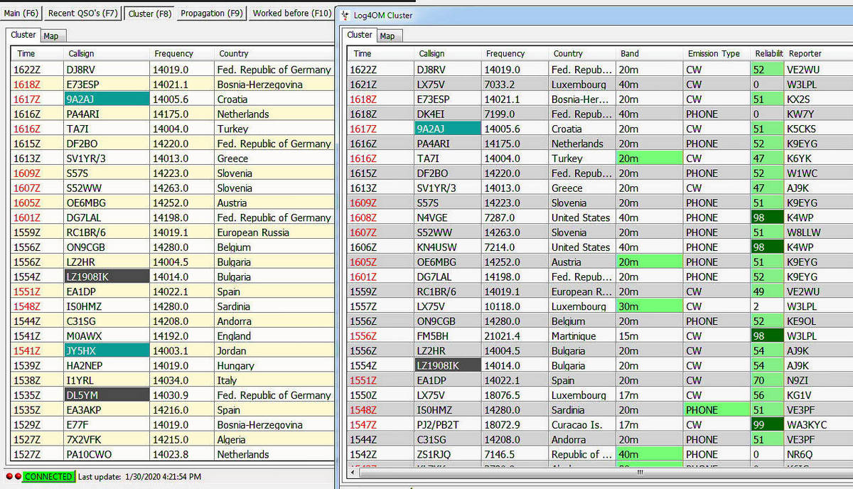

Not trying to pile on, but I'm picking up more spots in the detachable cluster window and in the band map window than in the main F8 window. Right now I am showing 42 spots in the detachable window and 28 spots in the main F8 window with the filters set the same way for both. This is with v2.2.0.0.
This is the detached window on top of the F8 window for comparison.

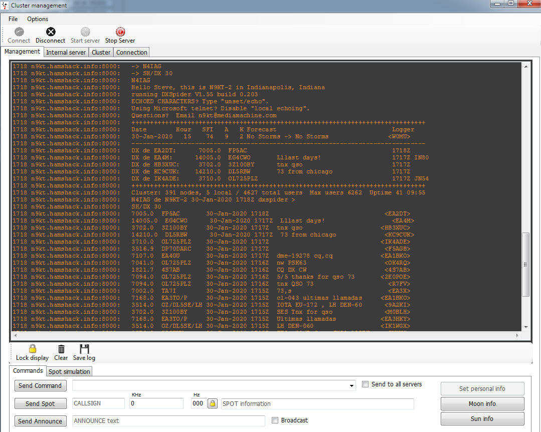

please send a screenshot of the telnet connection page.
Before doing so, disconnect the cluster and view the server you use to show the initial commands sent.

Steve,
You can have different filters set for each of those cluster views. Have you made the same or different choices for each view?

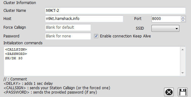

IK0TIX wrote: 30 Jan 2020, 16:55 please send a screenshot of the telnet connection page.
I'm having trouble getting much of anything to populate the main F8 screen right now. The detached window cluster and the one in cluster management tab are populated though. The cluster seems to work intermittently on the main screen for some reason.
I'm not sure what screenshot you wanted but this is my server setting (default) and the management tab when starting.

KI5IO wrote: 30 Jan 2020, 17:50 Steve,
Hi Nolan, yes the filters were exactly the same. I wish it was that easy though. :)
